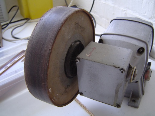

I had a problem until I purchased a Tormek

A final comment on the Tormek: I have one and love it, but I spend a lot more time sharpening by hand. The Tormek is great for nicks and introducing a hollow bevel, but it takes a few minutes to pull out and set up. That hassle makes me less likely to sharpen. The waterstone, on the other hand, takes thirty seconds to pull out, dampen, and start sharpening. It's easy enough that when your chisel starts to lose its edge, you don't think twice about taking thirty seconds to hone it. So, if you are thinking of investing $400-$500 in a Tormek, a better use of the money may be to buy a couple good waterstones and take a class in sharpening handtools. There are a lot of great woodworking schools around that teach a one-day sharpening course.

One of the best things about the Tormek,or for that matter, any very slow grinder is wheel diameter. With the Tormek 10" wheel, you get a very subtle hollow grind which makes for very easy secondary bevels and re-sharpening that doesn't gobble up your tools.Several of the jigs do great things with gouges and "V" tools.Either of them, Tormek, or Veritas jig makes for very consistent bevels. The abrasive isn't so important as the consistency,whether from experience freehand, or from a good jig. The flat honing surface is crucialThere are sharpening projects for which I use only my large Norton diamond plate with lily white arkansas and hard black arkansas bathed in mineral spirits. Waterstones groove and gouge very easily.I've only had my Tormek for a couple of weeks now,but it is a real workhorse. I'm maintaining about 20 planes a few spokeshaves and heaven only knows how many chisels. If I didn't have so much sharpening to do, I might get that first guitar finished. MT PS I finish up with hand or Tormek power strop. Just use care not to round over what you worked so hard to get with the flat abrasives.Also-the pathetic results of tool addiction.I have not yet learned to sharpen saws,but that is next.Miketobey38811.6192476852
